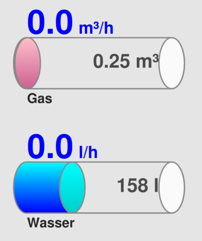

Anwendungsbeispiel
Auf einer FTUI-Seite werden Anzeigen für den Gas- und Wasserverbrauch benötigt. Die Daten stehen in verschiedenen Readings des FHEM-Device gaswaterProfileC
 <!--Gas -->
      <div style="position:absolute;left:230px;top:0px;color:blue">
        <ftui-label [text]="gaswaterProfileC:GV.P | fix(1)" size="35px"
          style="font-family:Helvetica;font-weight:bold;">
          <span slot="unit" class="size--2">m³/h</span>
        </ftui-label>
        <ftui-label [text]="gaswaterProfileC:GV.E | ftui_updatebar(20,'m³','g')" class="hidden">
        </ftui-label></div>
      <div style="position:absolute;left:200px;top:-30px;width:200px;height:150px">
        <ftui-content suffix="g" file="widget_bar.svg" fillside="url(#grad1p)" filltop="url(#grad2p)">
        </ftui-content>
      </div>
      <div style="position:absolute;left:230px;top:95px">
        <ftui-label text="Gas" size="14px" style="font-family:Helvetica;font-weight:bold;"></ftui-label>
      </div>
      <!--Water -->
      <div style="position:absolute;left:230px;top:130px;color:blue">
        <ftui-label [text]="gaswaterProfileC:WV.F | fix(1)" size="35px"
          <span slot="unit" class="size--2">l/h</span>
        </ftui-label>
        <ftui-label [text]="gaswaterProfileC:WV.V | ftui_updatebar(500,'l','w')" class="hidden"></ftui-label>
      </div>
      <div style="position:absolute;left:200px;top:100px;width:200px;height:150px">
        <ftui-content suffix="w" file="widget_bar.svg" fillside="url(#grad1b)" filltop="url(#grad2b)">
        </ftui-content>
      </div>
      <div style="position:absolute;left:230px;top:225px">
        <ftui-label text="Wasser" size="14px" style="font-family:Helvetica;font-weight:bold;"></ftui-label>
      </div>
